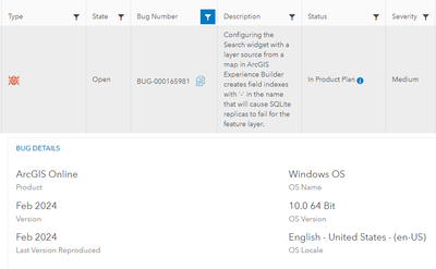

The offline area issue in my case was due to field indexes with invalid characters created by Experience Builder search widgets. You can check for invalid characters on each layer in a problematic map by going to the layer detail, settings, field indexes and checking for any indexes with hyphens.

This is interesting. I don't think our problem was related, but I'm hopeful this might be what's causing other packaging issues we have noticed, where layers that have not been changed in a long time start failing.
