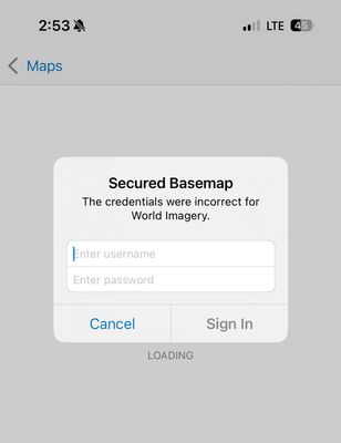

I am encountering an issue when attempting to use a map in Field Maps on an IOS device.
The Problem:
When the map attempts to load, a pop-up titled "Secured Basemap" appears, stating: "The credentials were incorrect for World Imagery."
This is forcing me to manually enter a username and password to view the map. It didn’t ask for this a few weeks ago, I was able go collect with no issues.

CodyPatterson
MVP Regular Contributor
Hey @TemesgenTesfay
This could be some type of cached data issue, have you attempted to fully uninstall and reinstall Field Maps? Also, have you checked the Account > Troubleshooting logs section of the Field Maps settings? There may be some indication of what could be going on there! If all else fails, I would recommend reaching out to Esri support, I remember a similar situation with Android not too long ago, but the resolution wasn't shared unfortunately.

TemesgenTesfay
Thank you so much, deleting the app worked for me!
