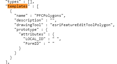

I see the space in templates.

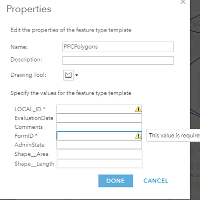

But when I go to fix it in templates it has no space.
I have tried adding and then removing a space and a few other things but it still stays with the space in the JSON.
Nullable is set correctly

Ok, I think I have a workaround for you.  I was able to remove the spaces/" " for the default values used in the PFC_Points feature layer by using Field Maps and removing them from the Templates tab.
I had to create a new feature layer, based on your PFC_Points layer to do this.  I then tested it in Field Maps mobile - and I am blocked from submitting because the 2 fields are empty.
