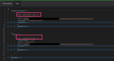

One guess I have is that a layer and/table have the same layer "id" in the webmap that was published. If you open the webmap data in AGO Assistant can you check if there are any duplicate "id" properties?
 These should be unique, so you could add a character to one if you do find any duplicates.
ChristinaHoddinott1
I checked and each layer and table have different layer IDs.
