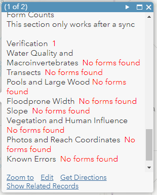

Not sure if they are supposed to match but you would think they would.
Web Map is set to red
Field Maps is Greenish

@DougBrowningis your phone using dark mode?
Currently, Field Maps (iOS) is taking the inverse color when the device is using a dark theme.
We have an internal issue to sort this out (probably for an update in March), since in some cases the color of text is very important and should not be changed.

DougBrowning
MVP Esteemed Contributor
Thanks I actually feel kinda stupid that I did not know this tablet was even in dark mode (its new).  Light mode does give me red.  We tell the crews to look for any red issues so good to know they may see green.  Red is important for this so thanks for adding it to the list.
