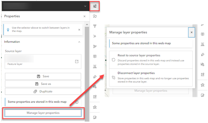

So far, I have only been able to turn off pop-ups in field maps by using the Map Viewer Classic.  I also do not see the option to disconnect layer properties for the problematic features as others have noted.

Also, I am not seeing the referenced "disconnect layer properties" under the Layer > Properties > Info, as noted in @ajevans429' s post.  We are using Map Services so may account for the missing option.

- I also don't see the option to 'disconnect layer properties', it is missing. I am also working with map services.
