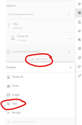

A potential workaround, until pop-ups are honored in Field Maps, is to use the text editor function to create something.
