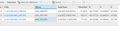

I have never used the tool much less geo tagged photo's.  So I just did a test run.  It looks like in my results that your results were created using the GeoTagged Photos to Points Tool.  I would guess then you did not have location enabled on your device, or your device is not capable of saving location info for the photos.
ScottSweet2
I've used geotagged photos to points tool in the past, with the same phone, with no problem, so I'm not sure what changed.  I checked that location was enabled on my phone so it is baffling to me.  The reason I tried using that tool in this instance is because I had to first use a script to get the photos downloaded from my hosted feature layer in ArcGIS Online.  I was hoping I would be able to use the tool to create a new points feature class after downloading all the photos to my machine but no luck.  I'll just have to re-do the work I guess.  My bad for assuming ESRI would keep x,y location of photos along a path that is "streaming".
