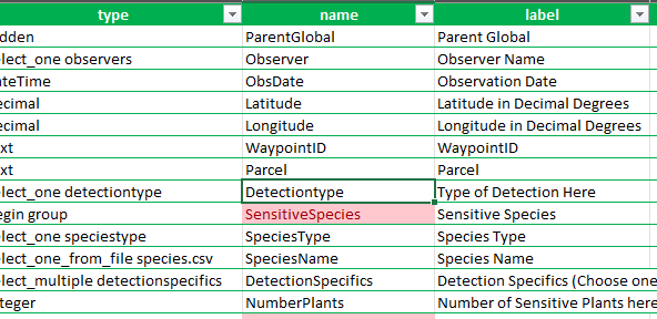

Yep would have thought that too but to me they look correct--here are the screenshots. Again it wouldn't make sense that it works with the Map Viewer if the names were wrong.
DougBrowning
MVP Esteemed Contributor
Why is SensitiveSpecies highlighted?  That usually means a dup field name.
Detectiontype is a select one.  Do the values of PTType line up with the name column of the choice list?  (not the label column must match name column)

I appreciate your help with this it seems like it is something so simple and it is nice to have fresh eyes. To answer your questions
Sensitive Species is the name of the Group. I named the Begin Group and the EndGroup the same because that made sense to me. Shouldn't affect anything since those fields don't collect data, but I can change those
Yes the coded values for the feature class are the same as the coded values for the survey 123 survey. I have double and triple checked that.
