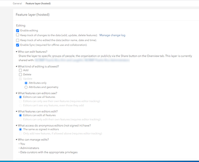

Have you enabled Editing for the layer? This is found on the item's Settings page, under "Feature layer (hosted)".
PeteVitt
Hi Ken - yes I have selected the Enable editing option in settings
