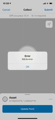

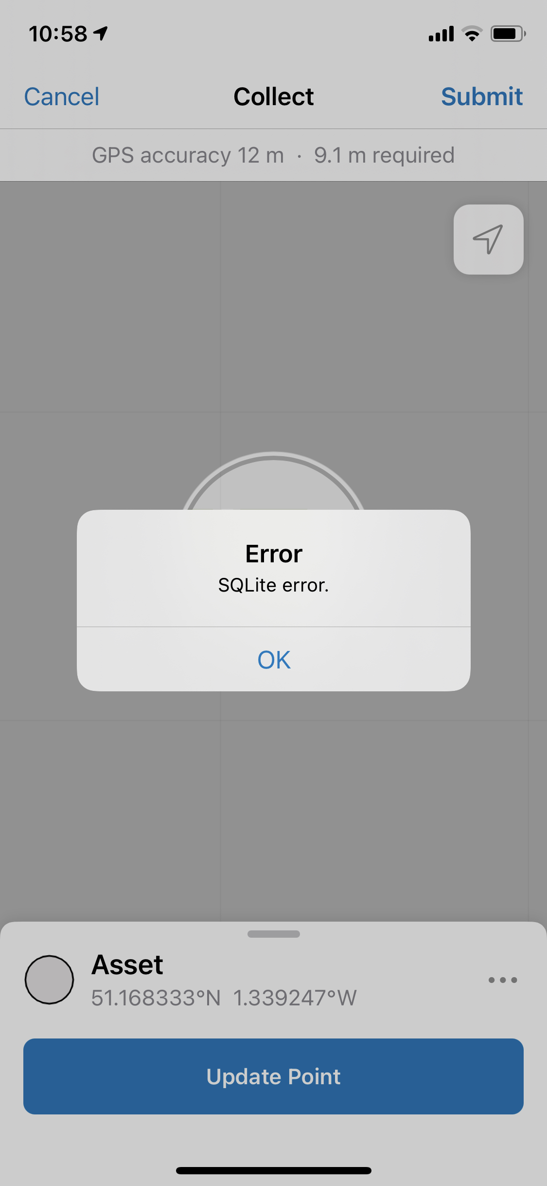

I have an offline map synced to my device, but whenever I go to submit changes, I get the below error:
This wasn't an issue before the latest agol/field maps update, and the app version I'm using is v21.1.0, build 385. My device is iOS. Also the layer I am trying to update is a view layer.
