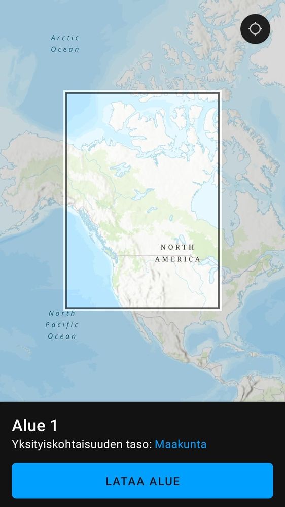

Hi, I'm wondering if this is the same for others, but the level of detail sizes when choosing offline areas to download seem to be way too big for their names.
For example the option "Province" seems to be the whole of Europe and a bit of Africa and Russia.

AleksiKokkonen
That doesn't seem to be the case. Even when comparing the size to Canada it is way too big (adding a picture for reference).
I'm wondering if this is a translation error in Field Maps.
