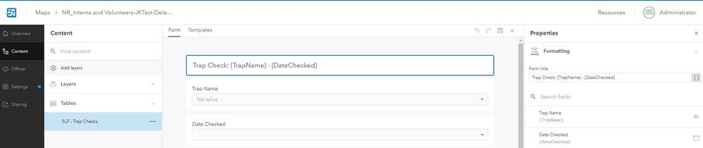

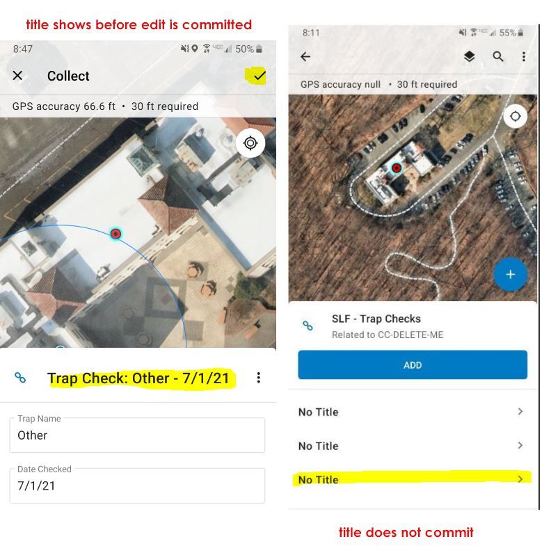

I'm not having this issue on parent features (in my case a point hosted layer), but I AM having "No Title" issues (see second image) on related table records using a smart form. (The table has a title set in the pop-up's configuration - see first image).     This issue is occurring on Field Maps on both iOS and Android devices using version 21.2.0 last updated Apr 7, 2021.  Anyone else experiencing this?  Is there a workaround?TitleSet.JPG

I'm having the same issue.  No matter where I set the title... either in the map viewer for the popup... and that's the title for each feature, not the generic title for the popup... or if I set the title in Field Maps, as @jkarmon is showing in her screen shots, I still get "no title".  In other words, I can't seem to do anything that make that not say "no title".
