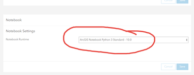

MappyIan
I was getting the same error trying to use item.delete(permanent=True) in an ArcGIS Notebook @GregHorne@Tom_Laue.  But once I updated my Notebook to use the latest runtime it worked fine and the item is deleted permanently without going anywhere near the recycle bin.  The Notebook Runtime setting is on the Setting page of the item in AGOL, I just set it to the most recent version:

Yes, @MappyIan -- that solved my problem.
