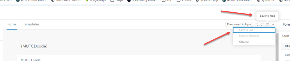

AGOL now allows you to save the form configuration to the layer itself, or to the map.  It sounds like your configuration is saved in the layer...
If you want to use the same layer in different maps with different forms, you should choose the save to map option.  If there are forms saved to the layer, it will pre-load them when adding to a new map.  However, you can edit/modify the form(s) and save to the map itself, and will not interfere with other maps/forms using the same data (unless you are using the save to layer option).
