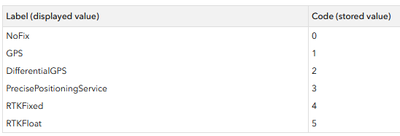

EDIT: I noticed that maps based on an earlier template (Mar 2025) did not have this problem. I think I have narrowed it down to the esrignss_fixtype domain list. Old versions have six values:

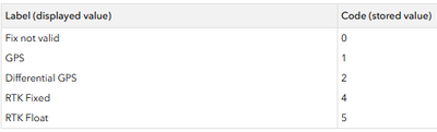

New maps/templates with GNSS enabled have five values:
I don't know why, but the new values seems to be causing the issue, as deleting this whole field fixes the domain issue...

Hi @TanithLives , sorry for the delay in this response as I just came across this post. The coded value "3" for these domains (PrecisePositioningService) is indeed what causes these loading errors in Field Maps. Point layers created after the Sept 2025 release should be fixed and not include this unexpected value. For newly created Line and Polygon layers with GNSS metadata, the fix is coming in the next AGOL update within the next couple of days.
For any existing layer that is running into this issue, the fix would be to remove the unexpected domain value as you have pointed out.
