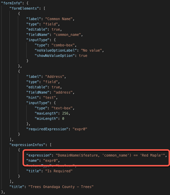

Conditional requiredness is supported but not exposed yet. Currently in the web app when you check the "Required" check-box it actually writes an Arcade expression of "true". We do have plans to expose an authoring UI for writing any expression - it won't be available until this fall or winter (at the earliest).
You could check the required check-box and save the form. Then use ArcGIS Assistant to customize the referenced expression.
Find the element you'd like to make conditionally required and find the name of the expression it references. In this example, I'm making the address field required if the common name of the tree is "Red Oak".
 Then change the "expression" from "true" to whatever logic you'd like.
 Then save the changes (note in Field Maps web, it won't show the required check-box as checked - leave it as is). If you open the map in the mobile app it should work like this:

@Anonymous User I have followed your example and have successfully created conditional requiredness in my form!  Many thanks!
