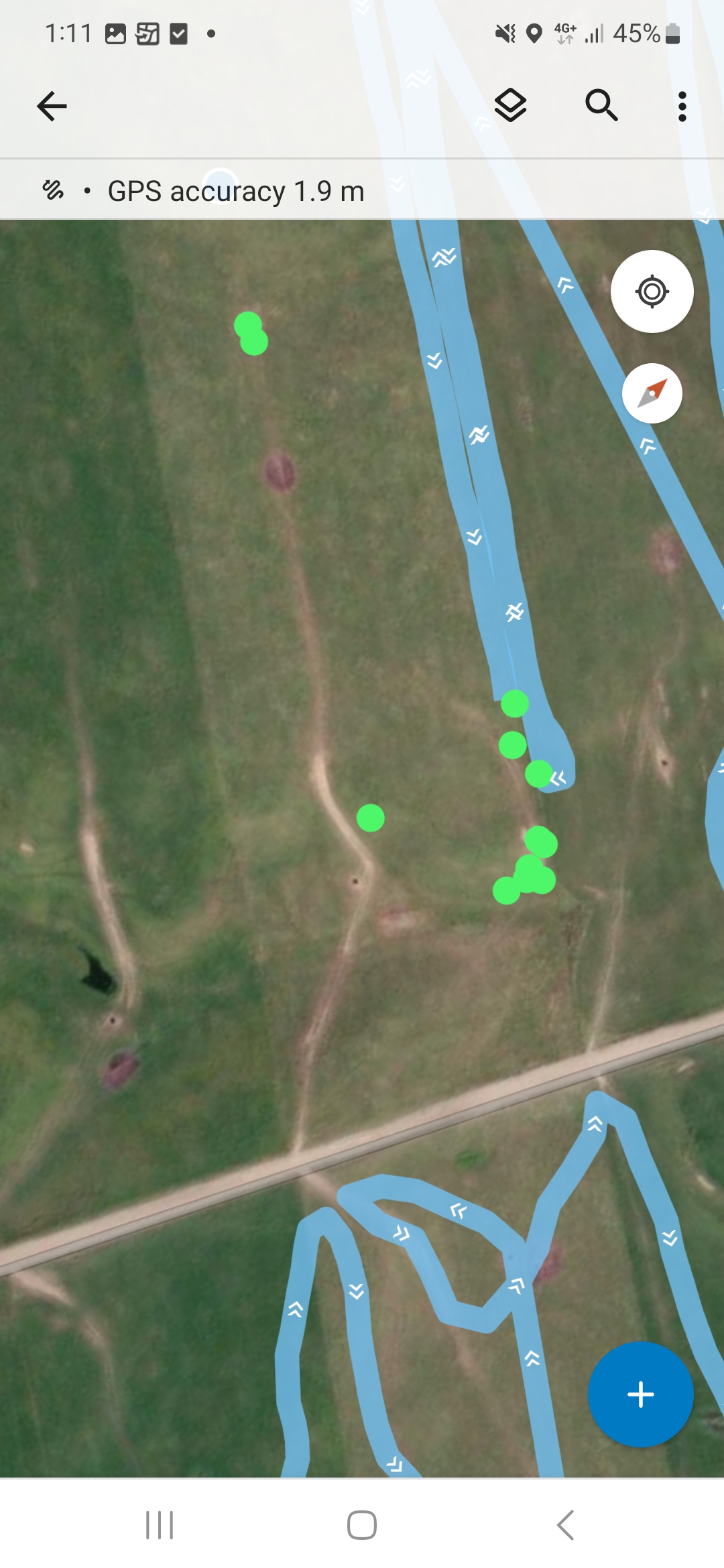

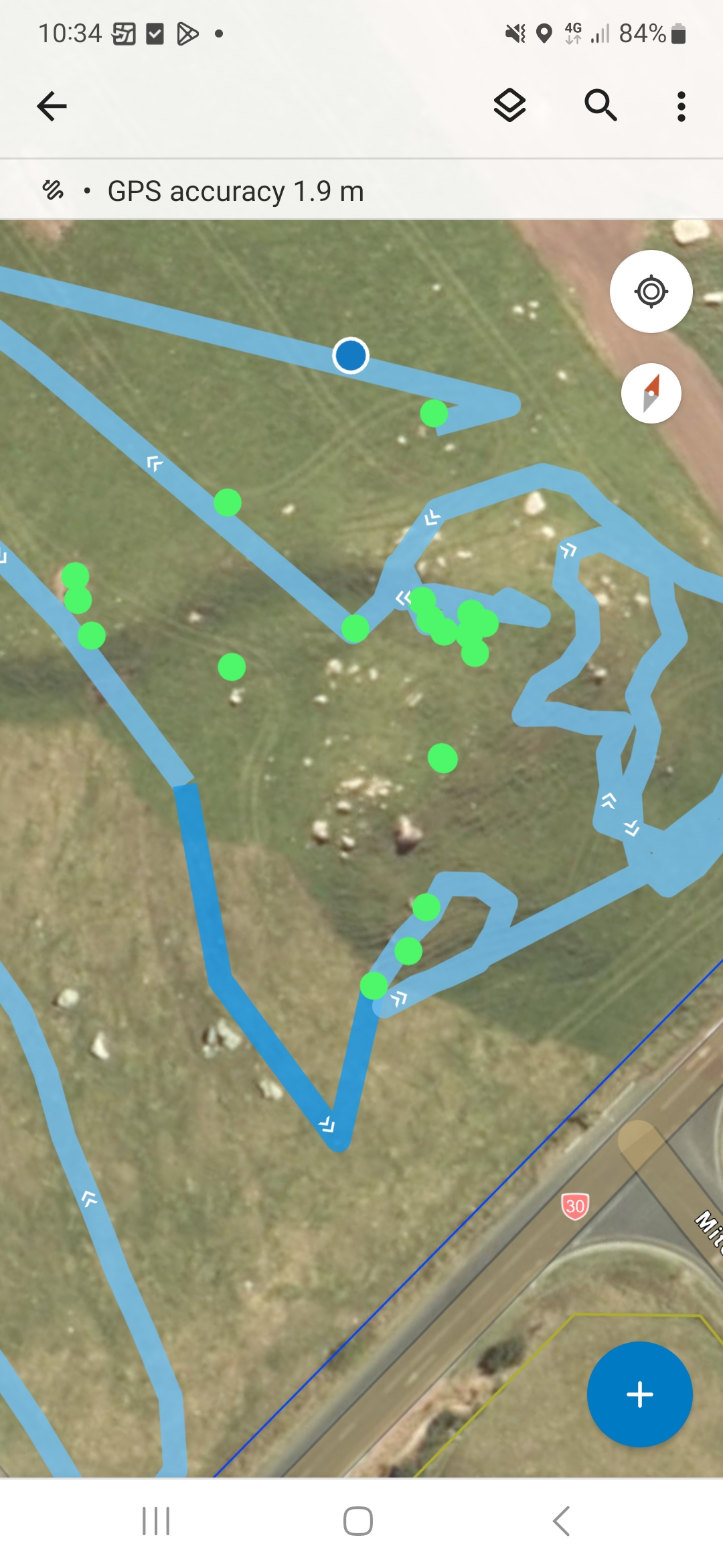

My tracklog does some random stuff sometimes and stops recording for a little while, same issue that I’ve previously had. I’ve been to all the treatment points but the tracklog just wasn’t recording/ doesn’t show and starts showing the location I have been to afterwards if that makes sense - so there’s basically a gap in the track recording.
In the screenshot below from her device the green dots (treatment points) are all ones she's created in the field on the same day so the blue lines (my tracks) should be going through them. Screenshots were taken that day.
Screenshot_20240808_103459_Field Maps.jpgScreenshot_20240808_131140_Field Maps.jpg

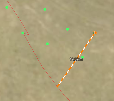

I then went into Tracker in ArcGIS Online and looked at the Tracks from the Location Sharing automatically created layer and compared that data with these screenshots. The tracks have cleaned themselves up some what. So potentially it is that she's looking at My Tracks on her Field Maps mobile too soon because these get created every hour, and it tidied itself up? I did a skim around the area, but still found some points that didn't have tracks collected for it like the screenshot below. That red line should be going through the green dots. It is important for us that the My tracks is accurate as possible since we use this to show to the client that we've done the work they've requested.

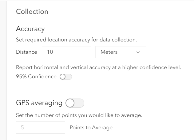

Below are the settings we've applied to their map in Field Maps Designer.
