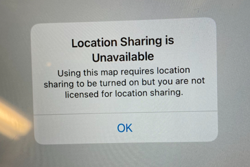

We ran into an issue with Field Maps and would appreciate your help.

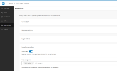

  • We created a web map with the new map viewer and then opened the map in the Field Maps web app and required location sharing.
  • We created a custom AGOL role which inherited our Data Editor Role.    We then allowed this privilege

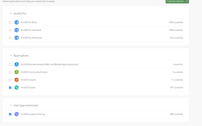

  • We granted the user the ArcGIS Location Sharing Add-on license (as well as ArcGIS Tracker for good measure)
  • When the user logs in to the fields and tries to access our web map, we get this error.

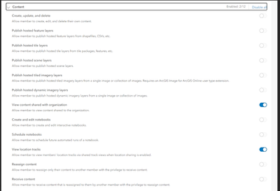

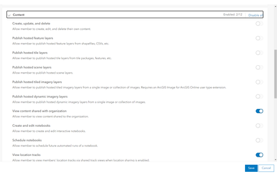

  • Following the instructions from Tech Support we change the user’s role to User and enabled the View Location Tracks Privilege as shown.
  • After following the instructions that the article recommended, we get the same error

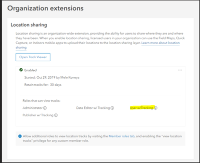

  • If we look at the Location sharing organization extension,  it looks like what we have tried should work
  • The only way we have been able to get the tracking to work is change the user’s role to Administrator, which is something we don’t want to do for 300+ users.

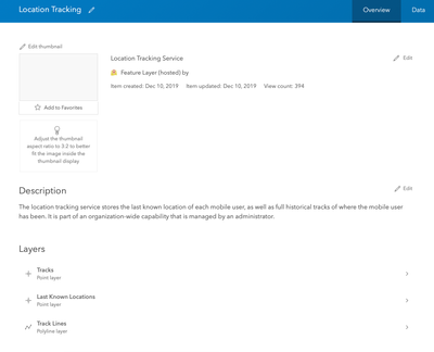

It is not the permission I was wondering about, it is the location sharing feature service item itself.  Is this feature service shared with the organization (the default and would require the users role to have the "View content shared with organization permission") or is it shared with the users in a group.
The location sharing feature service should look something like below and it the service the track views are created from.

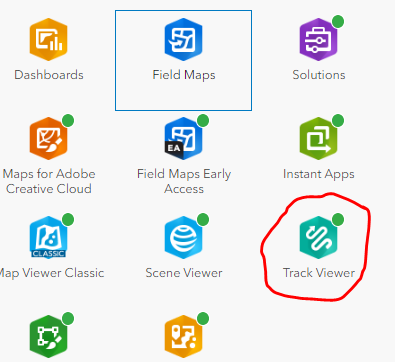

Did you create a track view in the track viewer application? You can access the track viewer application by going to the app launcher in your AGOL organization and selecting Track Viewer (see below).
Try creating a track view there and adding some of your users as mobile users to that view and giving them track viewing ability. Then add that  track view layer to a map in Field Maps. Your users should be able to start tracking in that map in Field Maps.
MeleKoneya
Thanks  Justin.   Our Tracking View was not shared with Org.   Only the owner and one group.    Let me try it some more.
MeleKoneya
Justin.    That did the trick!     I am not sure I understand how all this is supposed to work but sharing the Location Sharing Feature Server did allow me to start tracking in Field Maps.     I enabled tracking in 2019 and don't remember how it was done then.    It seems odd that we share the Location Sharing with the org but so be it.   If it works....    Thanks
