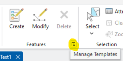

I figured this out.
Before publishing from ArcGIS Pro, go to the Edit tab, in the Features group, click the Manage Templates arrow to the bottom right of the group.
The Manage Templates pane will open. Select the layer of interest in the templates and remove/delete any option you do not want collected.
When using Field Maps only the one option I want is available for collection.
