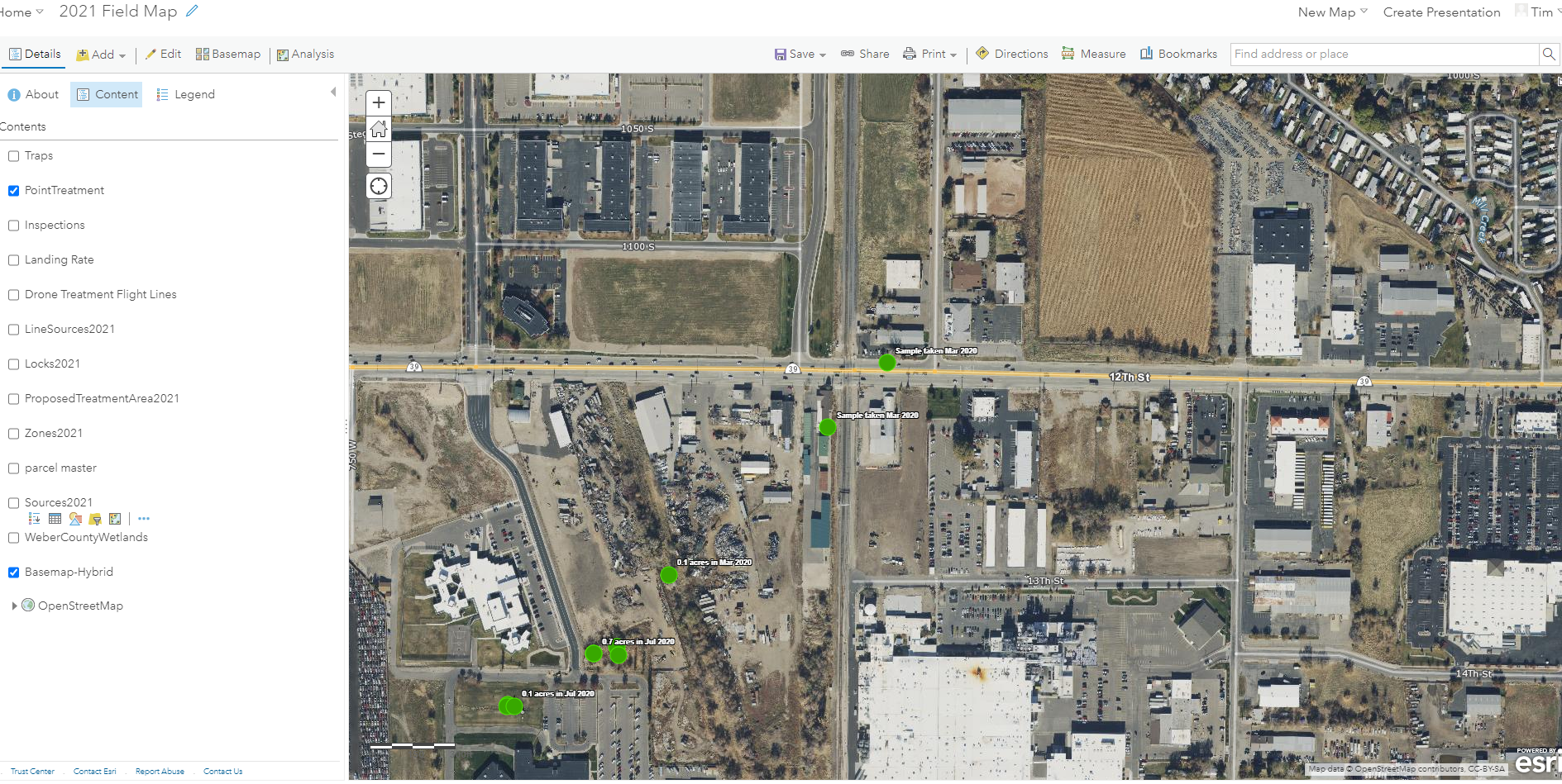

After I add this expression everything labels perfectly and looks like this...

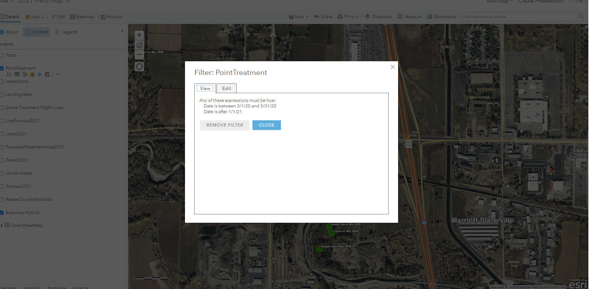

My next step is adding a filter that will only display data that is dated this year or march of the previous year. here is a screencap of the filter....

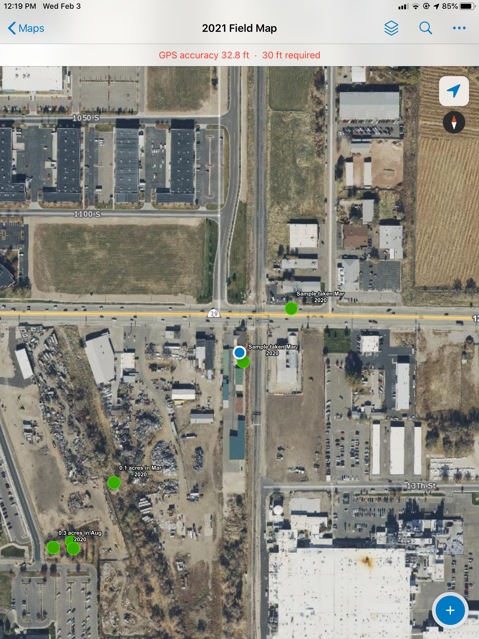

After that filter is added the labeling on Field Maps and Collector disappears but it does not disappear on the AGOL Web Map.
here are screencaps from fieldmaps with the labeling gone after applying the filter..
and screencap from agol with the labeling still displaying after applying the filter...
does anyone know why this is happening?
I feel like it is a bug on the esri's end, but if anyone has any tips let me know. Thanks.
