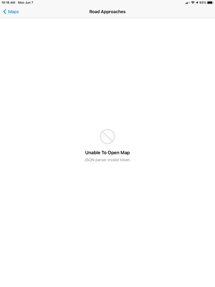

I'm beginning to make the switch from Collector to Field Maps and some of my maps will not open. I get the following message "JSON parser invalid token". Any ideas?

Have you found a resolution to this issue? I am experiencing the same issue with a web map I cannot view in Field Maps with the same error code "Unable to Open JSON parser invalid token" and I can also not view the map in the new version of collector and received the error message "Unable to Open Map invalid call with current token type"
However, I am able to view the map in the old version of collector.
