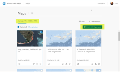

KenBuja
MVP Esteemed Contributor
Go into AGOL and open Field Maps. You can select maps that will be hidden to Field Maps mobile and only show the ones you want to display.

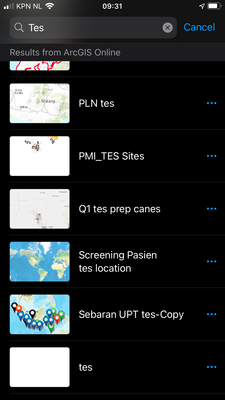

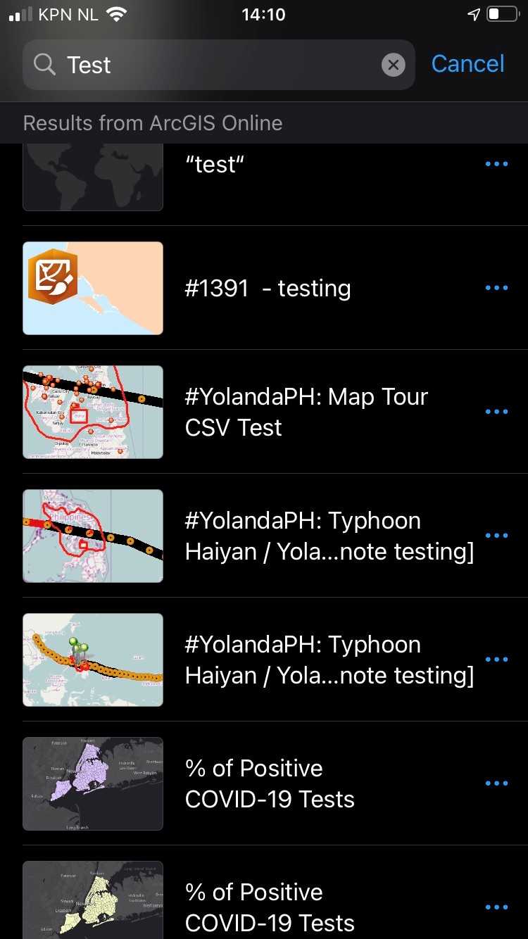

Gisbert61
Sorry, that does not answer my question, perhaps my question was unclear.
It is true that I can hide (a subset of) my own maps following your reply above and that is a very useful option but I keep getting lots and lots of stuff from esri customers all over the world:
This screenshot is an example of what happens when I try to search for 'test'. Before I even finish typing I get hundreds of results none of which are mine, none of which are of interest to us, none of which I want to expose my fieldworkers to.
I want to restrict what is visible/searchable to maps from within my organization. Does anybody know how to do that?
Thanks for your time.
Bert
