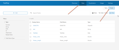

If you look at the Item Details data tab for the hosted feature layer, do you not see the field there either?
How was the feature layer created, and are you working with a view?

Yes, it's possible to add a field indeed in AGOL, i export a shape of my data and i add the field st_area.
For the moment, when i collect on field map on this data, nothing appear on this field st-area).
And, with my version of argis server (10.7.1), i can't have the possibility to add new field, and all the field create with arcgis (st_lenght, st_area) don't appear also.
I will create all my web map and data on arcgis server , not on agol. That's why, i didn't find what you show me.
I can't get all the parameters for the moment with my version like in agol. I 'm still looking for a solution...
