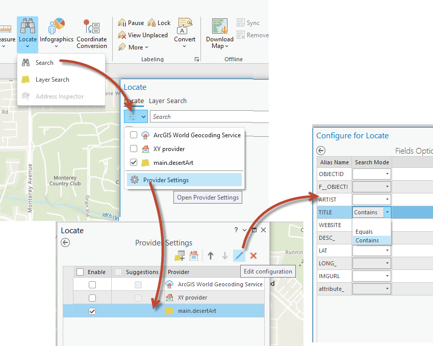

I'm making a map in ArcGIS PRO to share and use with FieldMaps and offline and I need to configure the layer to be searchable during offline use in the field
How do I perform this configuration in arcgis pro?
Tags (1)
MarkBockenhauer
Use the Locate button in ArcGIS Pro to configure the Feature Search
In the Field Map search results list it will show the attribute that is defined as the default for the layers display field.

RobsonCamposdosAnjos
Thank you very much, this was exactly what I needed
