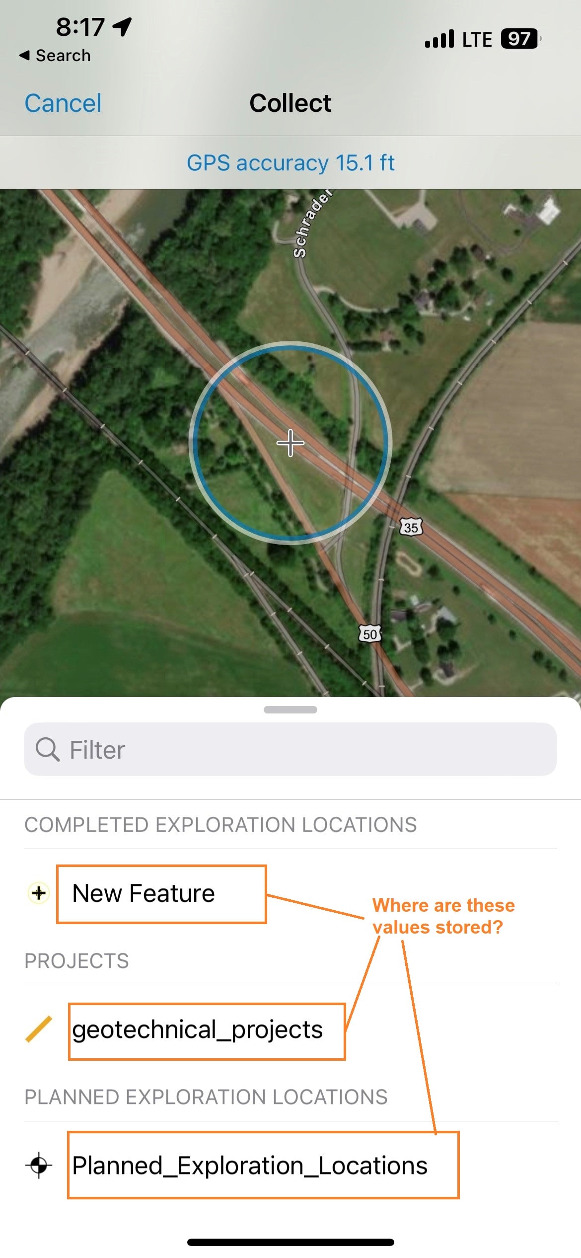

I have a map with three layers I created in ArcPro and published to ArcGIS online.  I want to change what is displayed on the initial collection screen in the app.  See below.  Where are these values stored?  I'm using Fieldmaps Designer and Maps to configure the map.  I cannot find these values in the metadata or properties.  Two seem to be from when I initially created the layers in ArcPro, but the other defaults to "New Feature".  This seems like it should be a simple fix, but I haven't been able to find it yet.   Field maps how to change what is shown in the collection screen.jpg

The best way that I've found is to update the Edit Template in ArcGIS Pro, prior to publishing.
However, you can open the webmap in Web Viewer Classic > Click on Edit at the top of the table of contents > Then click Manage at the bottom of the Edit pane.
Then you can add templates, default values and change symbology.
There is a similar Template Editor in the Field Maps web portal, but I don't think it has all the features of the Web Viewer Classic template editor yet

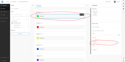

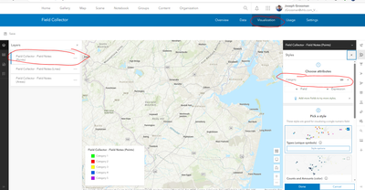

I had some issues with this before as well. It seems like it used to be easier to make the changes after the fact. Like KPyne said it is easier in Pro. You can change the symbology after the fact in the visualization settings of the hosted feature or in the webmap. You then can use the template editor in "Field Map Designer" ("Field Maps" - in Portal) to match that symbology. Make sure the field that you want to match is filled out correctly in the default values.

Thank you!  I haven't been using the classic viewer.  That worked perfectly and saved me the trouble of updating the edit template and republishing.

Thanks, this also worked for me.  With the classic map method detailed above, my custom symbology was replaced by a simple shape.  Also, I'm guessing classic maps will go away at some point.   Cheers to you both, thank you for taking the time to reply!
