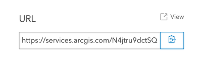

@LucasNeal there are two properties of the layer, allowTrueCurveUpdates and onlyAllowTrueCurveUpdatesByTrueCurveClients, that you can see in the layer's JSON.  What are their values?  Can you send a screenshot of the error/warning that you are getting?
From the service's item page, View

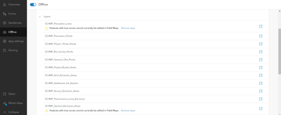

This is what I am getting in Field Maps Designer that prompted me to investigate this.
JustinColville
@LucasNeal the message you are seeing is just a warning message saying that your data has/support true curves, but Field Maps does not support editing true curves at this time.  As it is just a warning, you can still take this map and those layers offline and use them in Field Maps.
If you would like to be able to edit the curves in Field Maps, which will densify them, then allow updates to true curves (allowTrueCurveUpdates : true) but dont "Only allow true curve updates by true curve clients" (onlyAllowTrueCurveUpdatesByTrueCurveClients : false).

  • Not Showing Up in FieldMaps (despite being available previously).
  • Offline Enabled!  But Check Compatibility shows the Noted Warning... and the option to remove the layer.
