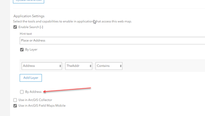

I have noticed the red pin now also when there isn't an EXACT match in my search layer (even, sometimes when there is).
Used to be if you enabled search on the map by layer, and un-checked the By Address box, it would only search the layer specified.
It seems as if after the update, that setting is ignored, sometimes?????
Often, if I have an exact match, it will search my search layer, if found, will select that result and zoom to the selection.  However, if the red pin comes up (which is from the By Address search that is SUPPOSED to be disabled), clicking on it will only zoom you to the location, and not select it.
Would be nice if this behaved as it used to before the last update.  If this is intentional, should have an options to use "By Address" when Layer  has no results, otherwise, would be nice if we could exclude the By Address search as we used to be able to.
