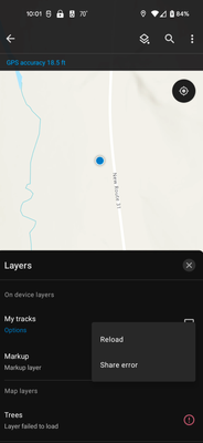

When this web map is loaded to The Field Maps mobile app on either ios or android, many of these feature service layers "fail to load." When we reload the map, often the layers that failed to load will flip with the layers that previously loaded. For example, layers x y and z, will fail to load while a b and c work well. Reloading the map will cause the exact opposite to happen.

@CPerry  When you experience a layer failing to load, you can tap on the error icon in the layers panel and then share the specific error that is causing it. That should help narrow down the issue.

 Thanks! Great call. Below is the error info:
Domain: com.esri.arcgis.runtime.error
Code: 3079
Description: Domain exists.

There's a support article with suggestions for this specific error: https://support.esri.com/en/technical-article/000020922
