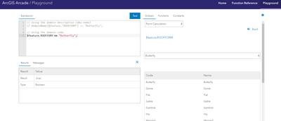

Did you test this in the arcade editor?  Does it return a Boolean value (true or false) when testing it?
Did you set this up as a form calculation by accident instead of as a visibility constraint?
Also, I preferer to work with the coded value rather than the Name/Description. They are are often shorter and less apt to be messed with for the sake of the user.
