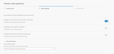

When you create the map in FM Designer, you need to enable High-accuracy GPS Recording. Then the map will collect GPS Metadata that will be in the attributes of each collected record. There is no way to change this setting once the map is created.
