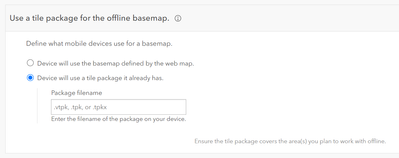

@MaryamPanji  are you declaring the name of the tpk / tpkx in each web map?
David
..Maps with no limits..
MaryamPanji
Hi David,
Yes, I did. Only a few people have this issue and others are ok. We used the instruction below:
