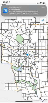

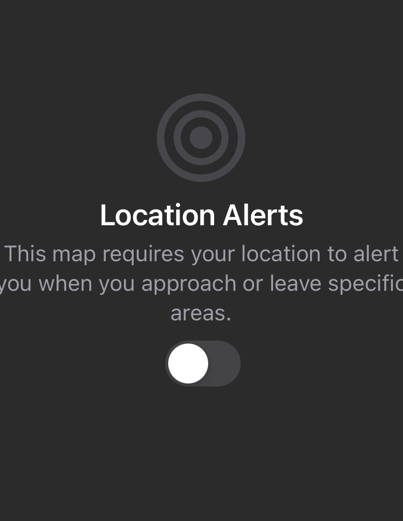

Hey Field Maps folks: I am investigating Field Maps as a candidate for geofencing on maps shared to the public. My prototype is to send a notification to the user when they are passing through one neighbourhood to another in our city. I configured the geofence with the Designer, it was super easy, this is really great. I downloaded the app on both Android and iOS. The Android experience has been seamless while the iOS experience has been rather poor.
I went to the webmap with anon Access.
https://fieldmaps.arcgis.app/?itemID=49a6141a05f64c4bb100b576a6b9894f&referenceContext=open&anonymou...

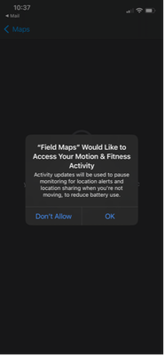

I was initially asked to enable the location services

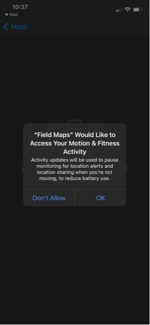

Then it asked me to access my activity.

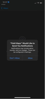

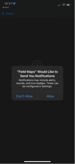

And finally Notifications

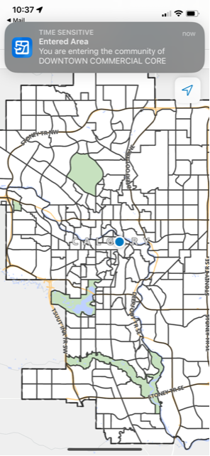

 I allowed all this and the app opened providing a notification
The issue came when I closed the app. I could no longer get notifications, and despite messing with all the settings on my iPhone that I am aware of the tool won't send me notifications. Android is a different experience entirely working every time I open and close reliably. Any reason iPhone would act this way?
Any advice is welcome.

@RossFindlayCOC Are you backgrounding the app on iOS or closing it all the way? If the app is completely closed iOS would only restart your location services after it detects a "significant location change" which can be high variable depending on your environment. Once this detection happens, Field Maps would restart in the background and continue monitoring your location (and you should receive geofence notifications when applicable). I would also double check your location permissions under Field Maps in the iOS settings and try setting it to "Always".
This shouldnt be impacting it but have you tested removing the URL portion of your workflow - ie browsing directly to the map and seeing if you can repro?

thanks for the reply  I am closing things and stopping the app as you stated  looked at the log and it looks like there is some token issue stopping the Location Alerts  the layer in the map is a hosted feature view that is shared to the public so I am not sure why there is a token issue. Log listed below

2023-06-09, 10:36:53 AM [LOADING] Layer (Alert Locations) failed to load with error: Error Domain=NSCocoaErrorDomain Code=3072 "User canceled error" UserInfo={AGSCredentialErrorKey=token: (null)
tokenURL: https://www.arcgis.com/sharing/rest/generateToken
tokenExpiration: (null)
, NSLocalizedDescription=User canceled error, NSUnderlyingError=0x28085d3b0 {Error Domain=com.esri.arcgis.runtime.services.error Code=499 "Token Required" UserInfo={NSURL=https://www.arcgis.com/sharing/rest/generateToken, NSLocalizedDescription=Token Required}}}

That is odd, I have not seen that token error before in this context.
Just to clarify, everything is working when in the foreground? You dont receive any sort of permission prompt (outside of the motion, GPS, notification system prompts)?

Was prompted the first time I went into the iOS but never again, even after closing. Once returning after closing I never received any sort of prompt but also didn’t recieve any sort of alert. On Android every time I reopen I am prompted, which I assume is the expected behaviour.
