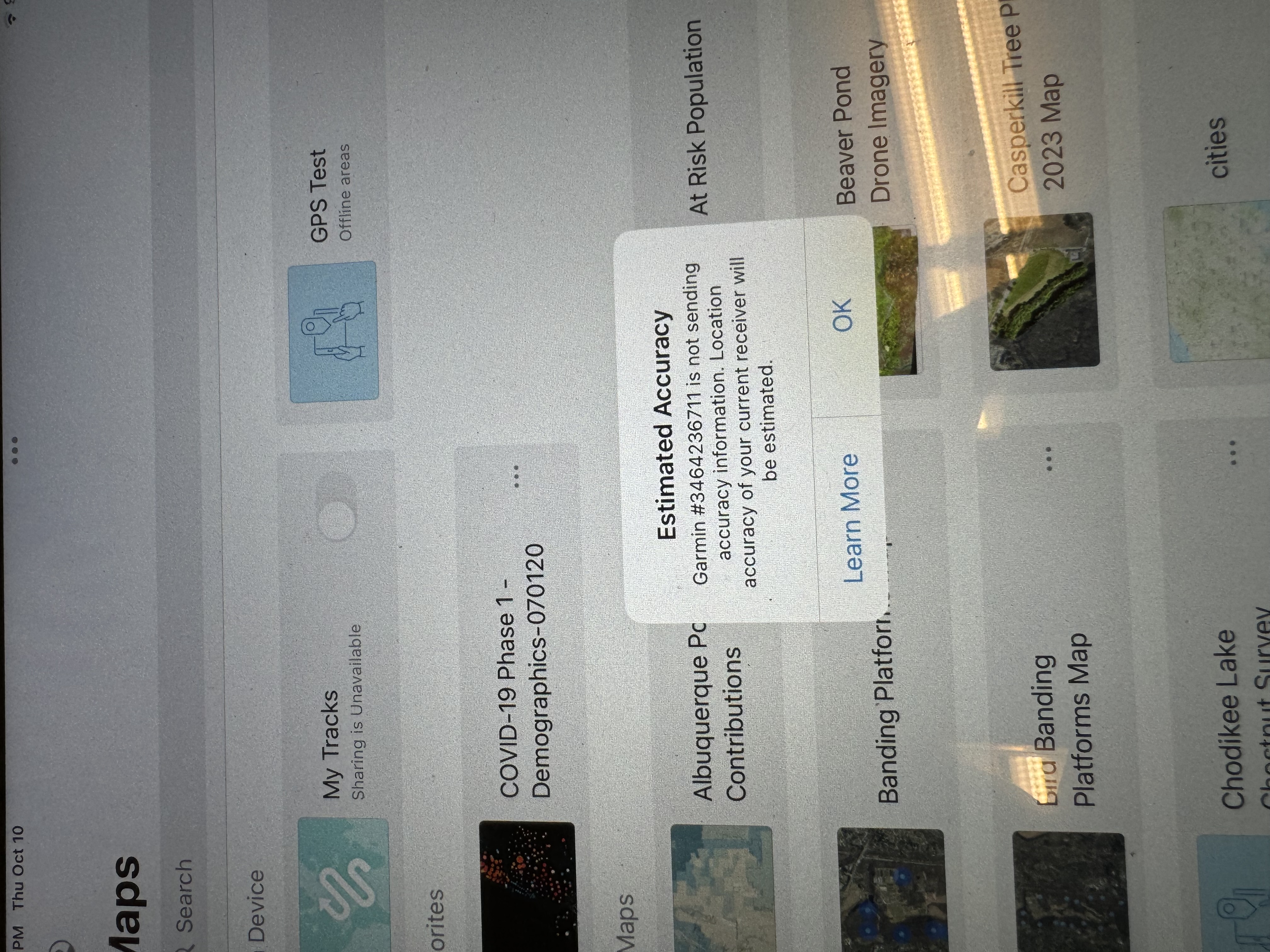

I'm having the same issue with my Garmin GLO 2 in Field Maps. I was getting this information and recording it in a Field Maps survey a few months ago. But I recently took it out again for some testing and now I'm getting the same error. However, and perhaps crucially -- before I took the iPad and GLO 2 out for some testing again this time, I updated iOS on the iPad. It was after that when I started having this issue.
I am also finding that Survey 123 is receiving accuracy information from the GLO 2, but on the iPad and my iPhone. I have 3 other iPads of the same model and the behavior is consistent on them as well. See attached screenshots/photos. I have an open support case on this with Esri. Will report back what I find out.

So, I just tried using Field Maps with the Garmin unit today and magically... I'm getting the GPS error info now. I'm glad it's working now, but I wish I knew why. Since I was getting GPS error information in Survey 123 and not Field Maps, I don't see how it's an issue with the Garmin. I did not update the firmware on the device or change anything. It didn't work three weeks ago. It works now.
