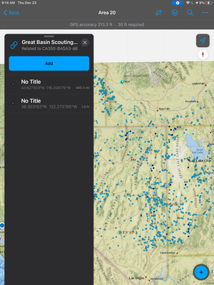

Hi everyone!
I would like to know how to reformat the titles shown in this list of related records. These related records are created in Survey 123 and have a designated instance_name in the form. I would like the title to either show the instance_name or the ID field from the record, {scoutingID}.
AKA: I would like to change "No Title" > instance_name or {scoutingID}. Anyone know how?

I think you need to configure the pop-up title for the related tables.
remurray
That was it, thank you!

Polesig
Found it, if related records come from tables and not feature classes, the table also gets a popup configuration in the MapViewer (API v4). This is where the configuration should be made.
