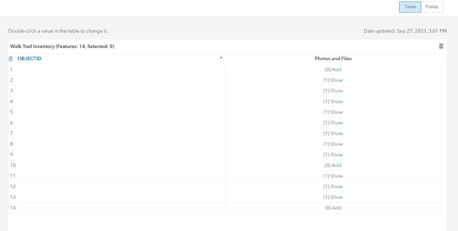

When I have come back to review each individual point on Map viewer, no details come up except the photo that I took. They appear in the "show table" when I click on the layer file.

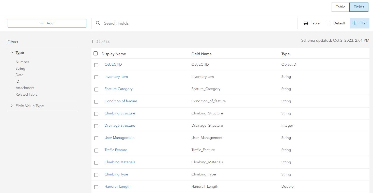

I opened the data tab on the feature layer details page. The table tab only shows OBJECTID and a Photos column. The fields tab shows all 44 of my form elements I created in Field Maps.

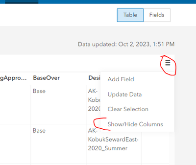

If you click the hamburger menu there at the top right then you can show or hide the columns you want.
Do they show there?
You can also open the layer in a web map and view the table or in ArcPro.
OGS_Trails
I've tried showing the columns using the hamburger menu. You can add all the fields as required. Though when you click the fields tab, then click back to the table tab they are then gone.
