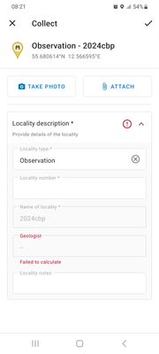

Are there any updates on this issue? We need to be able to log the full name of our geologists and not just their username when they are collecting data in the field in Greenland. The following code works fine when online, but not when taking the device offline:
GetUser(FeatureSetByName($map, 'Locality')).fullname
When looking at the offline data in ArcGIS Field Maps, the username is stored in the geodatabase and offline feature dataset, but the full name of the user are available in the ArcGIS Field Maps user credentials for the user that are logged in. Why can't we get the information from that instead?
