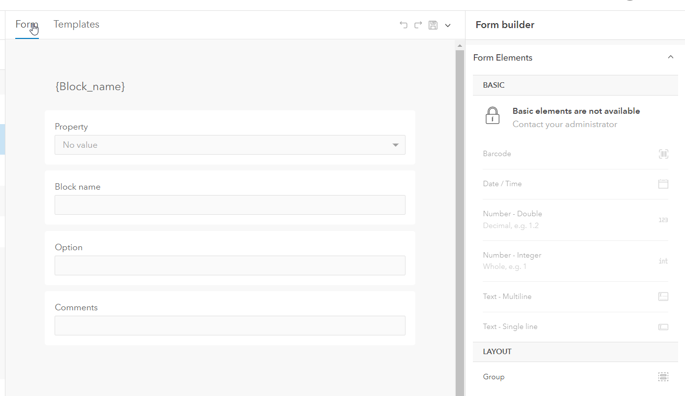

Hi Field Maps Community,
I'm creating feature templates in the Form Builder area. It's worked in other maps, but in one in particular, I am getting this message. I haven't tried creating a feature template in this layer before. I noticed I don't have the No Value option ticked in this data. Maybe this has something to do with it?
This is the message I'm getting.
When I go into the Templates Tab only the display name shows. None of the fields do.

@Marokapara  Do you own the layer that you are creating the form on? You can only add new form elements and fields if you own the layer.
Marokapara
@Anonymous User  yes I own the layer.
CraigGillgrass
@Marokapara some other reasons why this may be disabled:
  1. The user does not own the layer and they are not in org_admin role within the organization (you mentioned you own the layer)
  2. The layer is an ArcGIS Server feature service
  3. The layer is a feature layer view
  4. The feature layer has views that lock the schema of the feature layer
  5. Feature layer used to build a tile layer item
Do any of these apply?
