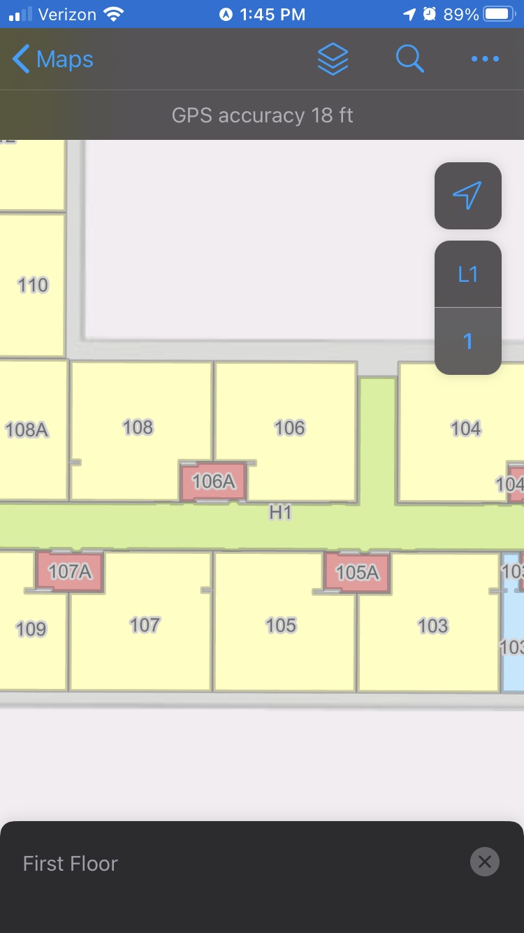

I've just ported over our Field Maps app map from AGOL to our new Enterprise Portal. Everything is working except the little black tab that pops up with the floor picker. I have the popup configured the same way as the Levels layer in AGOL, but no matter what I do or what floor I choose, the tab says "first floor" and doesn't change.  
LeviCecil
Turns out I transferred the wrong facilities dataset that was missing the NAME field!

MiaogengZhang
We recently updated indoor topic at field maps help doc dramatically https://doc.arcgis.com/en/field-maps/android/help/indoors.htm. It might be related to some part of data is not  appropriate.
If you have  a test account at Enterprise Portal available (assuming public accessible), you can email me (miaogeng_zhang@esri.com) the account, I can take a look.
