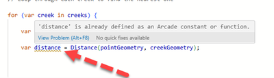

MarkBockenhauer
just occurred to me I did make one other change, The variable name 'distance', I modified to distance1 , apologies for omitting that bit.   you should see that as an error when authoring the form.
Scott_Gowan
Interesting,  I didn't get that flagged as an error.

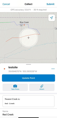

Scott_Gowan
Hey Mark,  Just to confirm.  In your scenario above were you adding a new point or updating an existing point?
MarkBockenhauer
both work,  new and updating existing.  I have shared my test map public for the moment, if you would like to take a look  https://www.arcgis.com/home/item.html?id=94c10beba7fb4a87b3cebed1750355c0
Scott_Gowan
Got it.  Thanks so much for your effort.   This will be useful in so many other apps.
