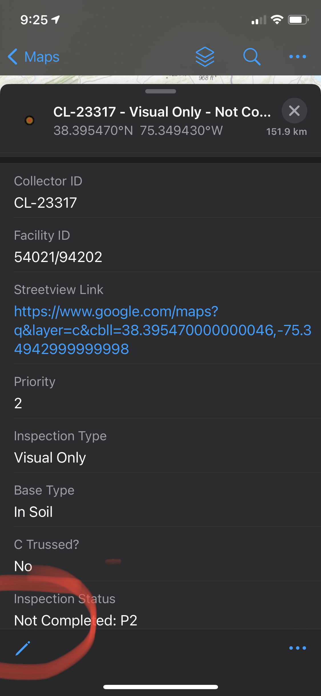

Screenshot of "Use in ArcGIS Collector" checked:

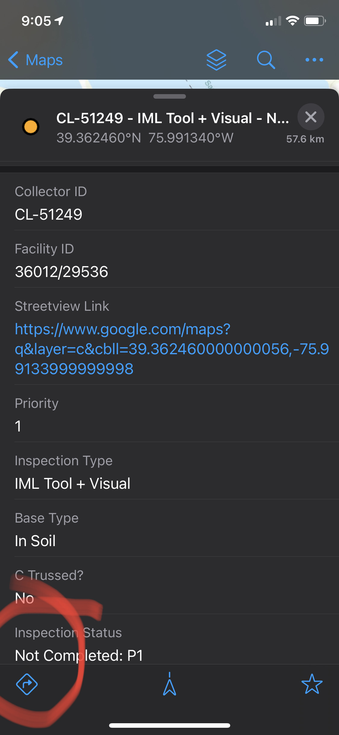

Screenshot of "Use in ArcGIS Collector" un checked (disabled):
Note that when "Use in ArcGIS Collector" is not checked, the ability to edit is lost.

@VH_MapS unfortunately the editing capabilities in Field Maps are being limited by the fact you've unchecked Use in ArcGIS Collector. This is something we're aware of and are intending to address in our June update. You can track or request to be added to this technical support defect.
