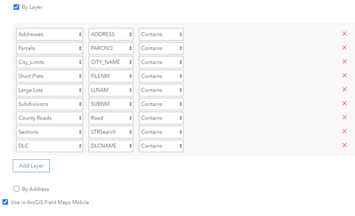

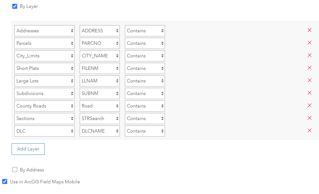

I m configured my field maps search settings in web app viewer classic, but the display fields that show up in field maps on my phone are different fields. How do I get the display fields to be the same as the search fields?
Here are my search fields:

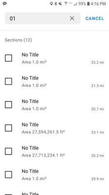

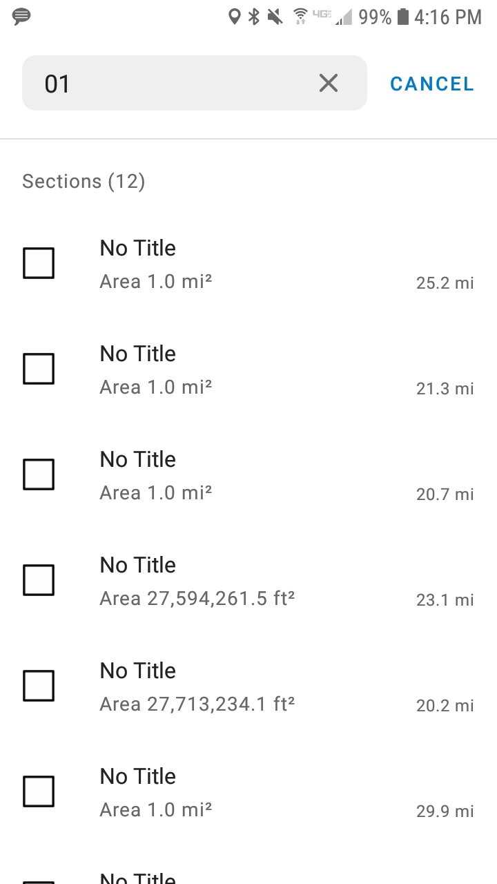

Here is what it looks like on my phone:

I configured the pop up window in web app viewer instead of in web app viewer classic then I turned off the pop ups and clicked save. That updated the search window in field maps.
