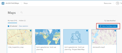

I should add that the web app for Field Maps allows you to select web maps and toggle their visibility in Field Maps.  This is not the same as mimicking the Collector status but does let you change status of web maps in bulk (a page of 20 web maps at a time).
