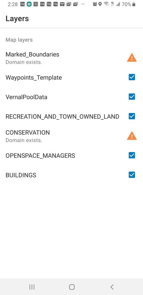

JBald
the error mentioned in this thread happened to me 2 times today and I am not using BETA.   app is also not showing all of the Field Maps, they appear and then disappear.  I have to log out and log back in for them to be visible again.     I am the admin.  also having a problem with one app not showing one of the editable layers.  I verified multiple times that it is set as "Visible" and "editable"  but it does show in the Legend, but has a yellow exclamation point with the words "domain exists"  It tests fine on the desktop, but not in the app.  other field maps I made work fine.   I am looking for a thread with this problem .  I attached a screenshot of the app
