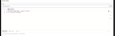

 After trying to code, this is the issue that I'm running into. Currently, I have a drop down menu for Common name, Scientific name, and Weed class and I'm trying to link them!
Do you see anything off with my attempt at the code?

Hey @CassidyWheat
That was my bad, I used the wrong equivalency check, I corrected it in my original reply, but this here should be about what yours should look like:
if ($feature.Common_Name == "Eggleaf spurge") {
return "Euphorbia oblongata"
You're just missing the double quotes after spurge and the ending curly braces.

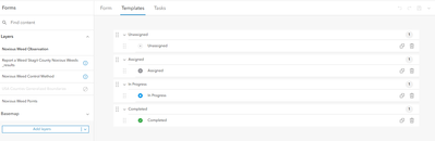

EmilyGeo
Hi @CassidyWheat
Yes you can do this without coding. You can create templates based on a field like common name, then set the default values for the other fields.
CassidyWheat
Hi @EmilyGeo , this is what the template section looks like on my end. I'm not sure what "unassigned", "assigned", "in progress" and "completed" mean in this context.
