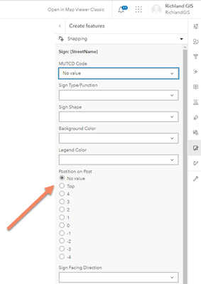

Are you using the new map viewer, not classic?
My radio buttons with conditional visibility works just fine in New Map Viewer:

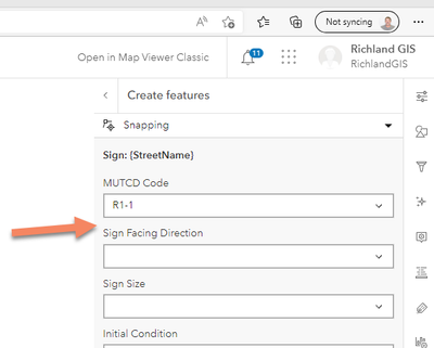

And when R1-1 selected, all fields between MUTCD Code and Sign Facing Direction are hidden, even the radio buttons:
