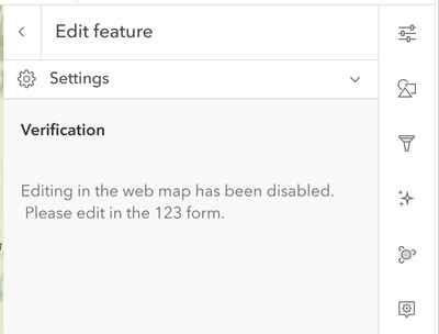

Seeing this same issue 3 years later.  We want to lock down editing so that the users make changes in the 123 form instead.
I was able to lock it down in forms by adding one Note type field with this message.  Leaving all other fields out and it works ok.
But then if they use Edit Multiple all the fields are open again.
I cannot lock down all editing as we need it available for the 123 form.  They can also just edit right there in the attribute table which I can not seem to turn off either.
Would love to see edit multiple respect the forms.

You can disable Edit Multiple in the App Settings in the Field Maps Designer as an option.
I also have used the ArcGIS Online Assistant (esri.com) to lock down editing on the web map itself as well, someone had outlined the process on a thread from a busted link above Control edit multiple at the field level of a form - Esri Community
