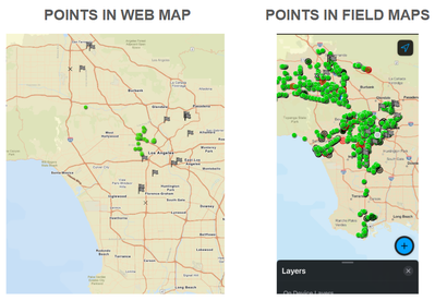

I have a point layer in an ArcGIS Online (AGOL) web map with a filter to show the features/points created in the last 12 hours. The issue is that points (not created in the last 12 hours) appear in Field Maps; the points do not in the web map (see photo below) which is correct. The layer-filter appears to be not honored in Field Maps.
I added the same layer to the AGOL web map without configuring the form via Field Maps Designer, and the issue did not occur. It looks like the issue lies with configuring forms via Field Maps Designer?
I had originally used Field Maps Designer to configure the form. It was behaving normally (only showing the points created in the last 12 hours) until on or around November 30, 2025 when our field-staff brought up the issue.
