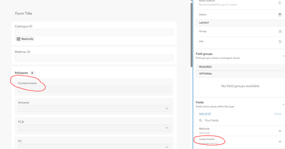

When inspecting the form in the Designer, we found that one of the already added fields appeared on the right-hand side Form builder as a field to add.
Even though in the Designer, there was no apparent reason why it would do that (all form field properties seemed to be correct), inspecting the field in the ArcGIS Online Assistant we realized that the form field was referencing a non-existent field (in our case, "Contaminants" instead of "contaminants")
