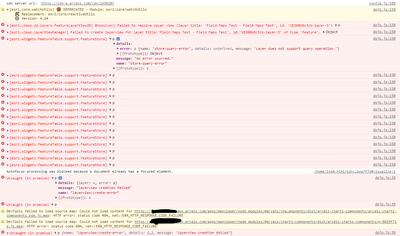

Well after submitting a point, I went into its web map viewer and clicked on "Forms" on the right-side panel. It acted like no form was built so I redid the template and saved. Soon as it went back to the web map, the point layer was throwing data errors. I haven't been able to access the feature layer since. Never seen a layer break like that before. Not a huge deal since I was just messing around, but does make me nervous about trying it in a production environment. Is there anything else that might have caused that?

@JasonJordan00 are you able to provide some steps so we can try and reproduce this?  How did you create the feature layer and related table in AGOL?  Do you have some examples of what Arcade expressions you authored in the Field Maps web app?
Anything to help us try and reproduce this would be helpful.  thanks,
